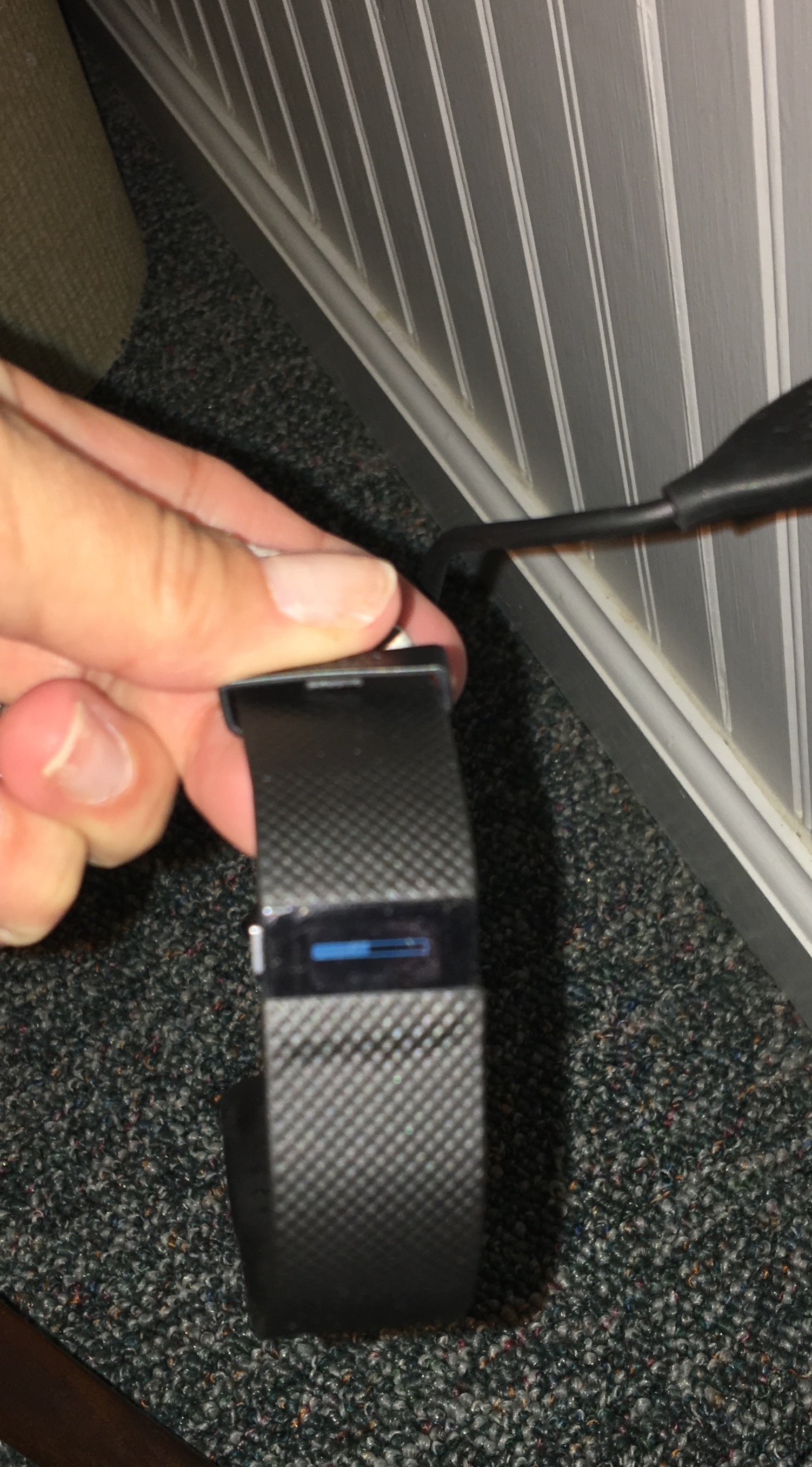

Best AnswerMy Charge HR did this yesterday as well but after the Error code 0X0009 I could never get it to ever come back. I tried resetting it all day yesterday and today to no avail. If I connect it to the charger now I get sort of a half bar for something although I'm not sure for what and if it is not connected, it's completely dead. I've had it for almost a year and this was my third HR sent to me from Fitbit before one completely worked (first one wouldn't record HR and second one wouldn't hold a charge at all). Any advise?
@JayMacT @Bzerk @Sashall It's great to see that you've visited the Fitbit Community. @Bzerk I'm glad to hear that you have fixed the problem you were experiencing.
@Sashall I would recommend following these steps to resolve the issue with your Charge HR showing a half battery charge. Hope this get you back on track.
