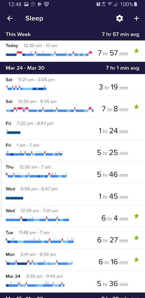

My solution from another thread: (Edit: Android only)
Many people will give you the old "please try these steps" spiel. I have found none of them to be the consistent answer. For quite some time, I just accepted that the band wasn't tracking sleep because of the fit, or because I moved too much in my sleep, or it lost the heartbeat. All of which would make basic sleep come up instead. Plus for me, it never syncs sleep unless I add it manually, which is another problem altogether.
Here is what I do instead, and I get sleep stages every day. I start the app, then turn airplane mode on for the phone. I wait for the app to say it is disconnected, then turn airplane mode off. I add sleep, tell it how long I slept, and like magic, sleep stages appear. If, in the rare event, it tracks partial sleep, I delete that one, airplane on/off, then add the correct sleep time. I have even been able to go back a day or three and delete/re-add prior days and they change to sleep stages.
As I have been able to get this to work consistently, I conclude the problem is with the Fitbit app. I hope this gives you actual help without having to go thru all the hoops that never worked for me.
Get your app fixed Fitbit!

You need to wait for the charge to sync, then turn on airplane mode, wait for the app to say connect to the internet, turn off airplane mode, wait for it to sync again, then you should be able to add sleep start and end and get sleep stages.
I am able to get it to work every day, so the only thing I can think is to make sure your app is updated. I suppose it could also be phone model issue. I have an android Samsung Galaxy 8+.
The sleep where there are no stages were naps less than 3 hours.
