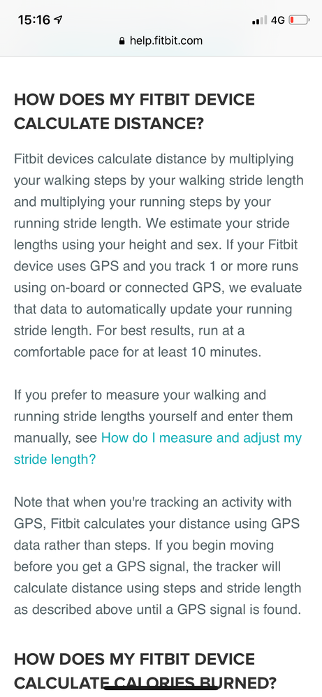

I did my first10km race this morning. My Fitbit Charge 2 was connected to my iPhone for GPS tracking and it recorded a distance of 11.3 kms!
Despite Fitbit literature stating that when connected to GPS it calculates distance using GPS (see below), this clearly does not happen. Today it was obviously calculated distance using steps x stride length. I’ve now set my stride length to auto which might help with a run of constant pace but if Fitbit doesn’t actually use GPS as it says it should, it all falls apart when pace is changed.

The Fitbit literature actually states "when you are tracking an activity with GPS, Fitbit calculates your distance using GPS rather than steps. If you begin moving before you get a GPS signal, the tracker will calculate distance using steps.............."
I watched as Charge 2 connected to my phone's GPS and regularly checked and know that there was a GPS signal throughout the run. Despite the above quote the distance of my run was calculated using stride/steps. My stride was set at 1.20 m, I did 9,430 steps and Fitbit calculated the distance at 11.3 km (1.2 x 9,430).
The GPS was not at fault as it measured 10 km almost exactly.
What is really disappointing is that all the training I did for the run was based on inaccurate data as I was rightly assuming Fitbit was using GPS data, when in fact it was only using stride/steps.
