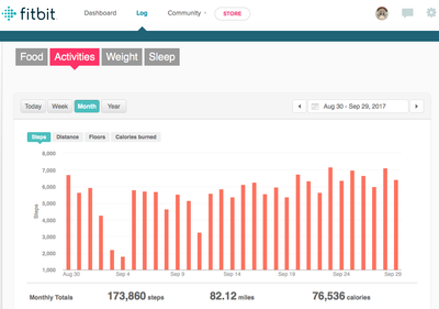

Sorry for the delay in responding. The charts are on the Activity Log Page on the web, with a smaller version on the app. Below the summary graph are the individual activity records for viewing. And you can hover your mouse at any point along the heart rate line to get the recorded heart rate for that moment in time.
