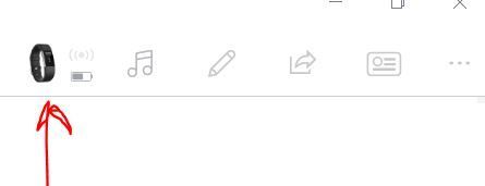

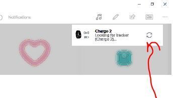

BMW, when you open your Fitbit App on a Windows 10 computer, there is a picture of your tracker at the upper right (see Pic 1 below) and, upon opening, the App should try to sync and there will be a little circle just to the right of the tracker pic and it will be going around. If it is not and any other time you want to force a sync, click on the tracker pic and you will get a drop down as shown in pic 2. Among other things, there are two circular arrows in the right side of that box. Clicking on those will force a sync no matter what is going on elsewhere.
pic 1
pic 2Please pardon the lack of artistry!
