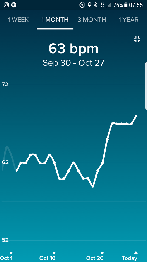

10-26-2017 23:53 - edited 10-26-2017 23:57
Since Sun 22 Oct 17 my rest pulse has rocketed from 60-67 and stayed at 67 all week, regardless of what I am doing.
Has there been another update in the firmware?

Exactly same problem here.
