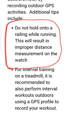

12-31-2019 09:09
And even that "G" even though they do have a special calibration for treadmills, they warn that it is useful if holding on. Also it is easy to find many complaints.
