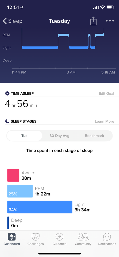

My Charge 2 has shown me getting zero deep sleep for the past two days. It records all other phases - but zero deep sleep.
Is is anyone else having this problem?

Unfortunately that’s not the issue - it’s not a matter of “not enough” deep sleep.
Previously I have been registering some amounts of deep sleep.
For the past two days there has been nothing registering.

I see. Well I would try a restart and see if that fixes it.
https://help.fitbit.com/articles/en_US/Help_article/1186
There isn't any separate configuration for deep sleep. It just comes along with the other sleep stages. You may want to look at that thread above anyway-- not sure what your benchmark is but 24 minutes of deep sleep is pretty low. Best of luck.

I had the same thing happen last night after re-charging my Versa immediately before getting into bed. It’s the first time that I’ve done that without spending a few minutes reading first.
I know I slept very well and I feel very refreshed this morning, so I just don’t believe the record.
I restarted my watch this morning,so will see whether that fixes it.

Try forcing a recalculation. I just adjusted my sleep log to start 5 mins earlier and Fitbit recalculated with 25 mins deep sleep.

I have registered no deep sleep for months.

It's clearly a problem with their algorithm since it does the same thing on the Sense, too. I cut off 20 min of "sleep" (it's shown as awake time anyway, don't understand how it is part of sleep) at the end of my sleep cycle and voila! - 20 min of deep sleep appear (which is still too low). Please fix, Fitbit.
