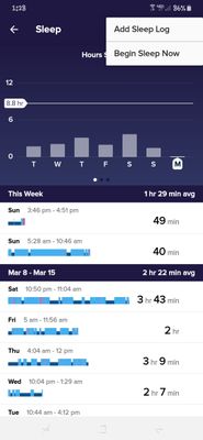

My non HR inspire has that I think it's the + button at the top of the screen on the sleep tracker part of the app. When I use it it at least says I actually slept, sometimes the sleep tracker doesn't even activate when i don't use it.

Here is a pic of the button I was talking about all it really does is tell the app that you are now going to be in bed trying to sleep from a certain time, when you start it, to when you stop it. Granted I do not have an HR but *shrugs* it's the begin sleep now one, you can also alter your sleep log so it shows from when you started to sleep to when you wake up, I can usually get a good hour or 2 of previously unrecorded sleep from just that, that is the pencil icon in the sleep log page for that night
