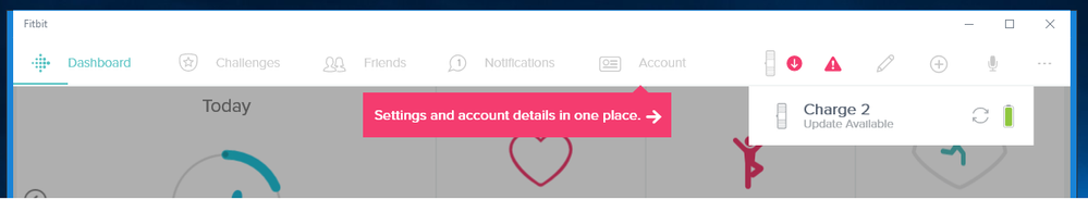

@resmus Welcome to the Fitbit Community! It's great to have you here!
Let me help you syncing your Inspire HR with your Windows 10 computer. Also thank you @fanofpi and @Odyssey13 for your kind help here. Usually if you are using the Fitbit app on your computer you can click the tracker's icon on the top right corner of the app. There you will see the sync icon where you can click it to sync your device.
Let me know how it goes.

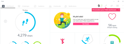

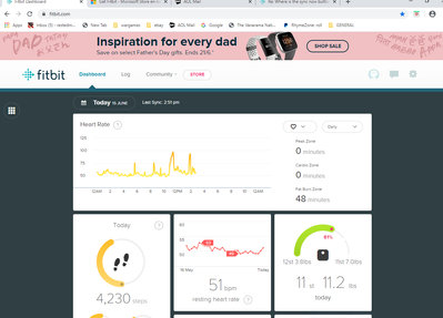

06-15-2020 11:02
06-15-2020 11:02
Hello Alvarofitbit
The problem is that my Inspire does not willingly sync most of the time.
The status is "paired but not connected"
I have done all the suggested solutions, Bluetooth on and off, update drivers, refresh Bluetooth support,add an extra Bluetooth dongle (which helps a little) and several others. None of them work
The only solution that I have found effective is to force it to sync by tapping the sync now button - sometimes many times - and this often includes getting the Fitbit app to repair with the tracker.
This can be very tiresome and tedious.
It does not help that on the Fitbit dashboard app (using the website) the sync now button is not to be found or at least I cannot find it
However relaunching the Fitbit app brings up a different dashboard and one that is not a website.
I attach screen prints of the 2 types of dashboard.
Website version
Relaunch version
Any help to resolve this ridiiculous situation would be appreciated
