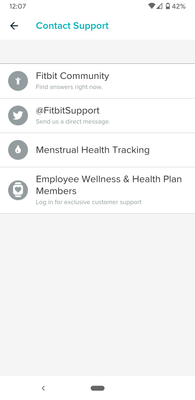

I had the chat option before and now i have nothing but this. Extremely frustrated
