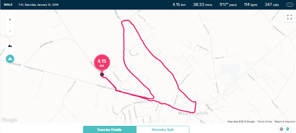

So I downgrade to 2.74.2 I think it is on my Android. Went for a walk this morning and to my surprise it worked perfectly. Connected near enough instantly and stayed connected throughout the walk. So obviously Fitbit have changed something since 2.74.2, The issue has to be with the fitbit app itself not the fitbit or firmware etc,

@dave_in_ni Yes and yes and yes. That's why I whine about 2.74.2 all the time. This is also the only build I know that will allow for Versa to sync and receive notifications without issues when there's Charge 3 (not recommended by Fitbit) linked with the Fitbit account. Having said that, this build will not support Today app fully (anything that has to be pushed back to Fitbit app e.g. water logging), fancy shmancy customized emojis in quick replies, etc.
