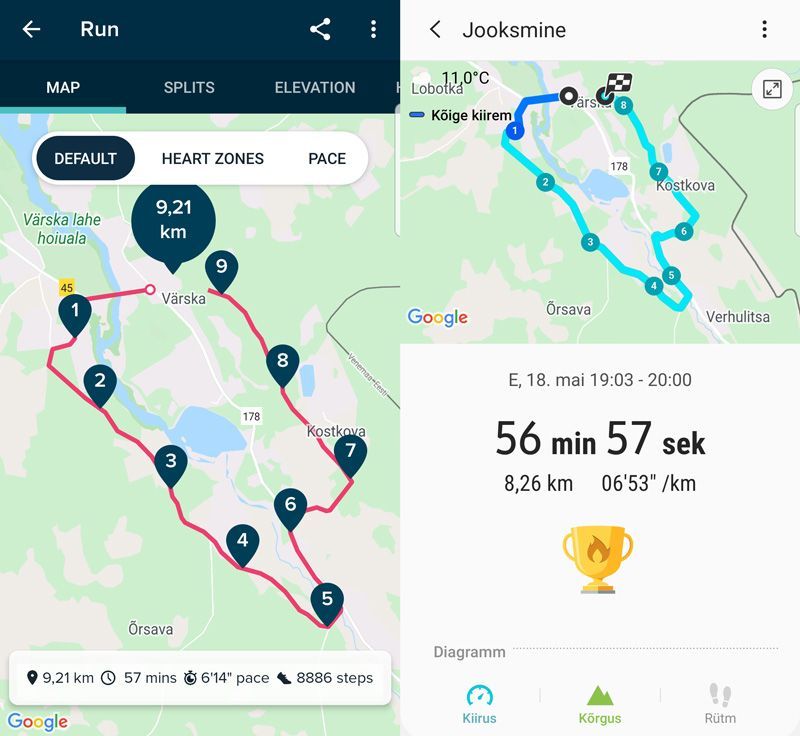

Picture says more than thousand words so... picture first.
How can it be that the same lap is measured THAT wrong. It is 1,27 km difference which is BAD. Both lines run on the same road so it can not be just "difference". Step count is the same and also the time. Which one can I trust at all? It isn't the first time it has happened (at least once more).
FitBit app is up to date. My Versa 2 is up to date.
I started my run the same way: opened exercise - choose "run" - wait FitBit to connect with "connected GPS" - start!
Also the settings are the same when I start the run. I activate "do not disturb" and "always on display".
Am I doing something wrong? Is the app so bad that it does not know how to calculate distance? Is it problem with my watch? I looked into it and it seems this problem has been with you for 3.5 years. Is there seriously no fix?

So I tested with Samsung Health (SH onward) and it showed me that the lap is 4,1 km long like I measured on the map. And it showed me 3 times the same length. And yes, I did reset my Fitbit day earlier.
SH on the left and Fitbit on the right. Measured the same lap at the same time so there was no difference in weather nor GPS signal strength.
SH showed me 4934 steps and Fitbit 4938, so it is the same.
SH showed me average pace 11'01"/km and max pace was 10'13"/km. Fitbit unfortunately showed me average 12'26" and low pace was 119'02"/km and high pace was 6'20"/km. I get the minimum pace, because I was walking my dog and i sometimes stopped for a few seconds. What I do not get is why my high pace was 6'20"/km, because I did not run.
Overlap for both SH and Fitbit GPS. They both run on the same road so GPS data is accurate.

More data.
16.05, cloudy weather. It rained at the end of the run
18.05, mostly cloudy (thin clouds).
20.05. Mostly sunny. One big cloud with lightning in west, nothing else.

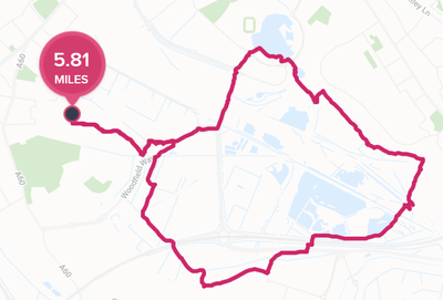

I went on a walk yesterday... 5.81 miles according to FitBit, but 8.07 according to "Map my Ride". Both have the same route in the map.
05-25-2020 07:11
05-25-2020 07:11
To further add to this... Here's the map in Fitbit, 5.81 miles:
Export the TCX file (available on the website), and import into GPXSee, and guess what... 8.1 miles...!
This proves that the Fitbit / GPS is working and tracking correctly, however the App is showing the wrong mileage.
