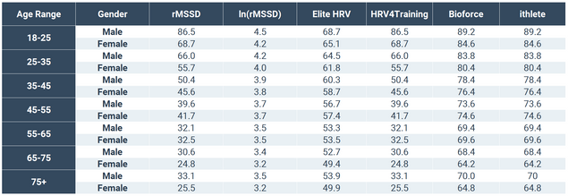

I just started receiving FB HRV data showing my HRV at 15, which seems quite low and I'm relatively fit with a RHR of 60 and a FB cardio fitness scor of 53.  This made me both anxious but even more, curious.  After some online research and reading other Fitbit community chats, I downloaded the "Elite HRV" app, which utilizes a polar HR strap to measure HRV, via bluetooth.  I got a reading of 52 on the first try.  There seems to be a view that a chest strap provides more accurate HRV information vs a wrist-based monitor, but I don't know if that's true.
More importantly, the Elite HRV site has numerous articles with useful background on HRV.  One of them has this table below, which indicates that there are multiple HRV software programs that use different metrics to report user HRV (their app metric is the 3rd column).  I don't understand why there are so many different metrics for measuring the same thing.  It's also not clear to me what metric Fitbit is using to report HRV and how it compares to these other metrics.

@eltoo The optical sensors are unable to detect RR intervals (for that you need ECG equipment, H10 does that). Instead, they detect PP intervals. That shouldn't matter as the sinus rhythm RR and PP intervals are the same. However, the measuring method with an optical sensor that may have not been designed for it (for example, not high enough sampling frequency) may affect the accuracy and more aggressive error correction may have to be put in place. That may result in smoothing out the data and lower overall results within the specified time domain. It doesn't mean it's inaccurate. It's just at a lower resolution.
In here I posted an analysis of a month of data between Garmin and Fitbit optical HRV (night). The difference between both readings may be a result of two things - methodology (a table you posted shows how it may affect the final result) and time domain. Since we are talking about sleep HRV, the time domain may be slightly different (depends when the sleep is detected on both devices) and a method used to obtain a result. But overall, the trend of both readings matches quite well (and if I get the data from last month and a longer period I observe visual matching of the overall trend). People focus too much on a single number without much knowledge of how it is being calculated, how sensor errors affect the results etc. For me, two different devices provide different absolute results, yet very similar relative results. Whether this indicates accuracy? Scientifically, on some level, yes. Mind that EliteHRV isn't made for all-night HRV measuring (and they explicitly say that, although it is possible to do, I never tried).
Answering your last question, the reason why there are multiple metrics (companies like to call them "scores") is to bind you to a particular solution. Most of them offset some paid subscriptions for more in-depth analysis (EliteHRV does). Having proprietary metrics prevents users from migrating.
