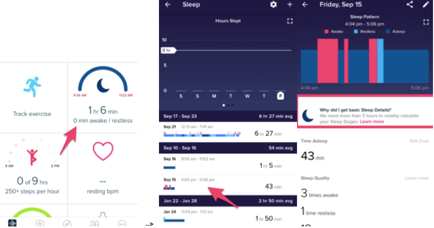

Hey, I've had my Fitbit since Monday and it logs my sleep but not the sleep stages? I have removed the app on my phone and re-installed it, re added my Fitbit (twice) and changed the sleep time started (read this online but no luck!). Any ideas would be great!

@LucyAP I had the same problem last night - got 4 hours sleep (the page says you only need 3 hours + for sleep stages so I should have fallen into that bracket) but instead I only got the basic sleep pattern. Please note that this is on PC Webpage so is not an app issue but poss a whole page issue ...could this be looked into please.
