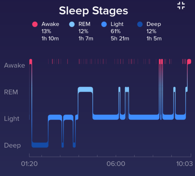

Even if it fragments. It needs one 3-hour window of uninterrupted sleep. But it fails to do even that. Screenshot of a sleep session with no spo2 reading in the morning.
