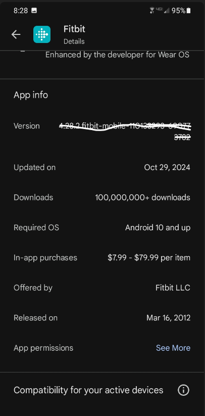

Updated using the 10/29/24 release via google play store (auto update applied) - again lost connection - signed out of app - rebooted phone, rebooted watch, signed back into app - requested re-pair of my versa. chose to 'reconnect' ...process failed, and continued to fail. App release still not compatible.
