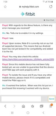

Same, Note 8. Customer service to me to come here and search on my own. Sure glad I bought the device from them. NOT!

I cannot possible express my disappointment enough. I truly feel that fitbit has no loyalty to their customers!I purposely bought directly from them and bought the extended warranty from them!They blame the issue on my Note 8 but can't tell me why it does the exact  thing with my daughter Apple iPhone 10, or my wife's iPhone 8.What do I have to do to get fitbit to understand that it is a watch issue not a compatibility issue?
 when I purchased this watch, it was compatible with my device... But now that everyone has issues.. Its magically not compatible. I do my research and would have just gotten a fricken galaxy watch if it wasn't compatible. Piece of sh*t
