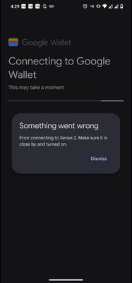

Just thought I'd sign in to report that the latest firmware update has done nothing to address the "Something went wrong error" with Google Wallet. Thanks for the new features that probably don't work either though! Fantastic work.

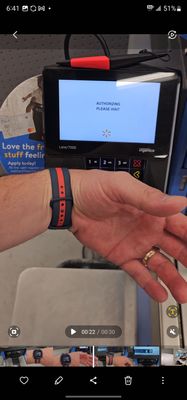

Got some great news! You know that "Something went wrong. Error connecting to Fitbit Sense 2. Make sure it is close by and turned on" error? Welp, I fixed it. And I'll be releasing a video here on YouTube hopefully tonight, so you can fix it too. Warranty replacement devices will now have Google Wallet returned to the Sense 2 in all its glory. There is also a chance it may fix some of the other issues as well. Excited? Me too! More to follow over the next few hours.
Lol you are never going to believe how you fix this error. Confirmed working at terminal in pic above!

I can confirm that this solution works! I'll refrain from entirely stealing Wave54321's thunder since I suppose he wants traffic to his youtube page, but the bottom line is that if you set up Google Wallet on the watching using an IOS device (iphone -- or in my case, my daughter's ipad), it works just fine! Once you have Google Wallet set up with your card, you can switch back to syncing the watch with the Android fitbit app and it will continue to work.
The catch is that if you want to add a new card or modify the google wallet settings, you still need to use the IOS device. That's right-- the Google Sense 2, using Google Wallet does NOT work properly on Google Android. You need an Apple device. Kinda mind-boggling but there it is...
look up the you tube video referenced in the earlier post for the step-by-step details.
