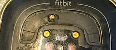

You can glue the strips back on, however it's very tricky, needs a very
steady hand & only a few tiny, tiny drops around the edge. Be warned - it's
very easy to stuff up unless you're practised at it. For that reason I do
not recommend doing it yourself, but have a jeweller or watch repair person
do it properly. Your local MR MINUTE or shopping centre shoe repair stand
would be good at that sort of thing, and won't charge a fortune for a quick
fix like that.

Did Amazon have a warranty on this ?  Did you register it with Fitbit ?   Not sure what you paid but there are  parts available at a repair shop in Washington State (do a search for Joes )   There are videos out there .

PS - I bought a 3rd party used one last May as my original Sense 1 died out of warranty .   We were leaving for Europe so I grabbed one one used ..  . Fitbit had offered me a 35 % discount on a new sense 2 which I bought from them when we got back from Europe .   The used one had the same problem as yours did but have a spare now - and I was able to get the parts from a third party . It was a lot of trouble .

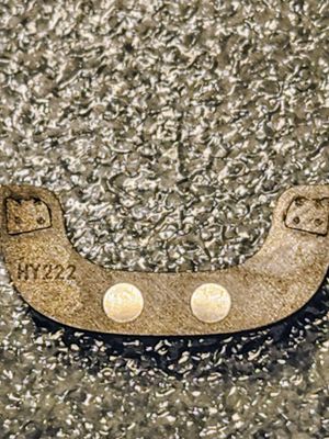

I've just experienced the same issue with my device. This is the second Fitbit I've owned that developed problems just weeks after the warranty expired. Like others, I contacted support and was offered a 35% discount on a new device. However, given the cost of replacements, it's clear that either the warranty period should be extended or the discount should be more substantial. Most people can't afford to buy a new device every year at these prices. Fortunately, I have the means to repair this properly myself, but I’ll be exploring more reliable alternatives.PXL_20250515_021416821.jpg

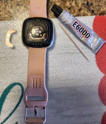

Updating my previous post.  Glued the bottom piece back on using E6000.  A week later the top piece came off.  Glued it as well with E6000.  I used a tiny paintbrush the 1st time and a toothpick the second time to apply the glue to the metal piece and the watch itself.  Cleaned old glue off 1st with alchohol swab.  So far is holding for a few weeks.  I agree with many posts.  Quality is disappointing.  So many users having the same problem right after warranty end?  My last Fitibit had the same problem.  Right after warranty end the heart rate sensor stopped working.  I love Fitbit bit won't buy again without extended warranty or may buy amother brand.  Not encouraged to buy a Google watch after what has happened yo Fitbit.
