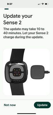

There is a firmware update I need to install and I go through the whole process but when it gets to the end, the update button won’t press. I’ve restarted my Fitbit and phone multiple times.

When I go onto the Fitbit app on my phone it states update I click on I agree after reading the info the next page shows in green Update I press nothing happens.  So I have to click not now and it goes back a page and states update available.  Yes I have my watch on charge.  Any help would be appreciated

I have the same problem - Fitbit Ace 3 connected to iPad, watch is connected to Bluetooth, plugged in and charging and syncing, but pressing firmware update button does nothing.  Says there is an update. Rebooted, reset, etc, still doesn’t work. Google bug?

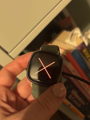

my Fitbit also keeps dying at about 30% and the battery runs flat so quick. When I try and turn it on, it often comes up with a big red ‘X’ on the screen. I don’t know what’s going on. Wouldn’t expect it from a 2 year old device
