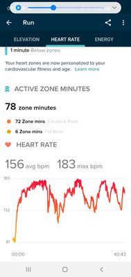

I think thats a general thing with optical sensors. I just did a run having bought my sense yesterday.
Just a note it did an update while setting up.
I did a run outside just to test the HR and GPS(used map my run on my samsung). The HR seems to be in line with my old Samsung in terms of consistentcy. It got up to 183bpm max, I think its still lower than the true high as I did a hill sprint to finish but overall positive (graph below)

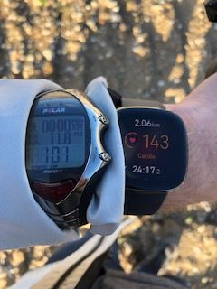

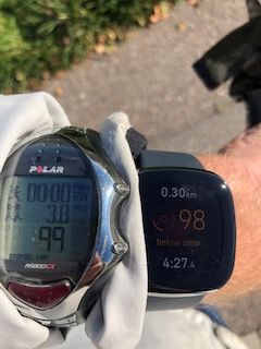

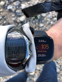

I have upgraded from Inspire HR and noticed a similar drop i HR during some exersises.
I dusted off my old Polar watch with chest HR monitor for comparison as I got a little concerned reading above. What I found is the Sense is very accurate however it is slow to react compared to the chest monitor. The Sense is quicker than my Inspire HR. the Inspire would during brisk walks put me in the 110-120 HR range, provide plenty of zone minuttes where the Sense keep me just below 100. This make me wonder if some of the problems above is similar, that the older watches where inaccurate compared to the newer Sense and not the other way around?
I have added a couple of pictures comparing the two watches. During steady walking, either slow or brisk, the HR is very accurate. Climbing a steep hill, the Sense falls behind and only reach similar HR at the top of the hill, thereafter it takes a bit before the HR drop down during rests.
Conclusion: My copy of the Sense is accurate but as expected not useable for short burst high intensity training. What it need is a special profile when selecting weight lifting exercise where it give priority to quick changes rather than precise readouts.
Steady walk Polar 99 Sense 98
Walk small hill Polar 106 Sense 105
High hill Polar 150 Sense 105
Top of hill Polar 144 Sense 140
Short break Polar 101 Sense143
