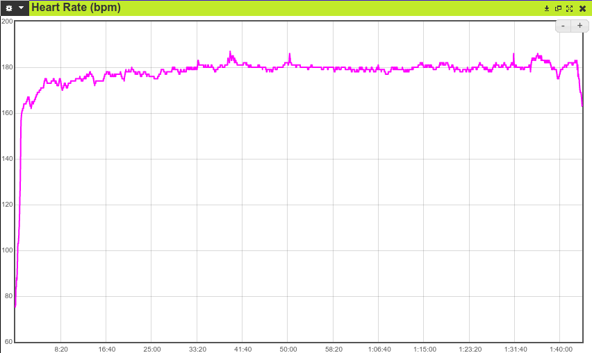

Polar H10 (chest strap):

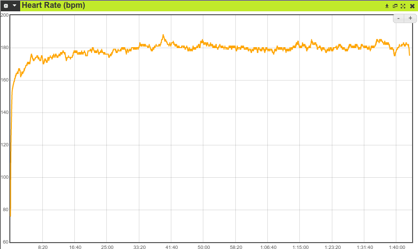

Polar OH1 (armband, optical HR, worn on the forearm near elbow):

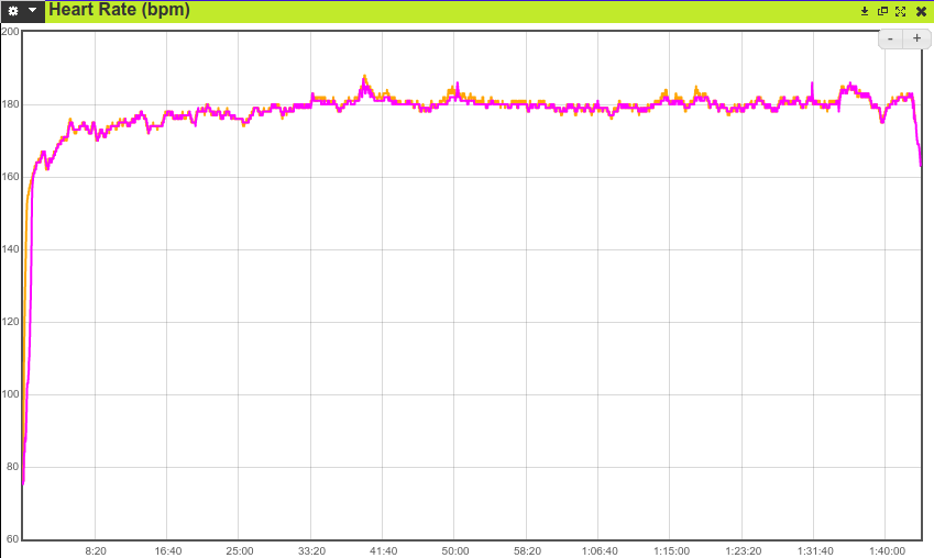

Now PolarH10 and OH1. Despite totally different technologies (first uses electrodes like ECG, the second is optical just like Fitbit watches), the results are very very close:

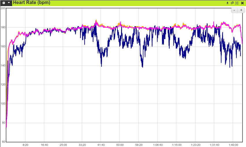

 and then Sense comes to the party (blue graph):
Not that I hoped anything would be better...

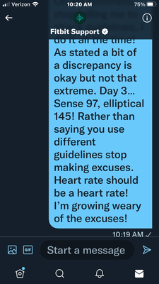

Today’s update Sense versus elliptical! Sense 97, elliptical 145!

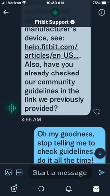

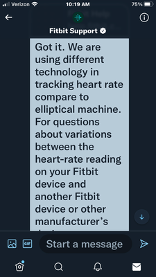

Attaching photos of the nonsensical response from the Fitbit techs!
 Tey beyond my comprehension!
They will just keep telling you that, because they don’t want to come out and tell you they sold you something that doesn’t work the way it should. I am sending my Charge 5 out in todays mail and better get my full refund back. As I noticed on the refund email I got that it states “This is an estimate. Actual refund amount is subject to applied discounts, tax, shipping costs, and item condition.”
I legit better get my price I paid for it back, minus the $5.95 they soaked me on for the return. Or they are so not going to like me.
@Irish57 it's a pretty standard Fitbit's response. I've been commenting on that in the past. A person has only one heart. There is only one heart rate that can be correct at the time and technology has nothing to do with it. With two different readings there are only two possibilities:
- both readings are incorrect,
- one reading is correct, the other isn't.
They can't be both correct. It's obviously impossible.
On the previous page of this thread I added this response comparing PolarH10, PolarOH1 and Sense:
https://community.fitbit.com/t5/Sense/Heart-rate-inaccurate-on-Fitbit-Sense/m-p/4979354/highlight/tr...
PolarH10 and PolarOH1 use different technologies, too (one is ECG, the other optical), yet the results overlap while Sense shows very different results. PolarOH1 matches PolarH10 (different technologies). Sense doesn't match PolarOH1 (same technologies, both are optical sensors).
By justifying bad readings with differences in technology of readings I risk saying that Fitbit may not be qualified enough to design and manufacture such hardware.
