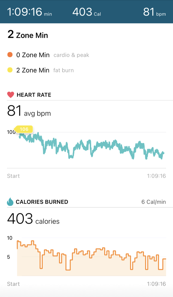

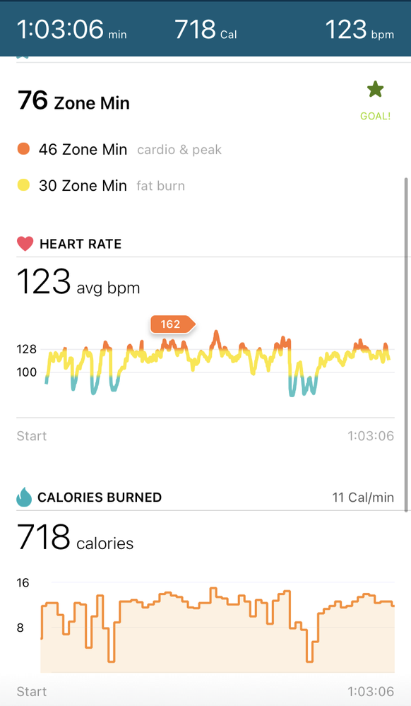

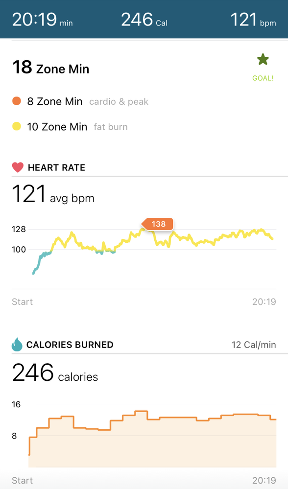

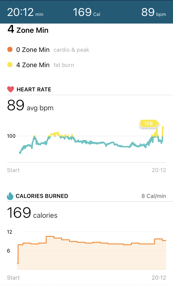

What a disappointment from Fitbit.
Bought brand new Sense as unwanted gift for 200 euros but took risk for a non-refundable item.
Expected to have massive upgrade to my Ionic of 3 last years that works quite well despite sync problems with my ex Huawei.
Sense seems to sync better than Ionic and every functionality worked well until my first workouts.
I have two types of workouts: weights and short cardio sessions. As a matter of fact Ionic lags with pulse after hard sets of weight lifting but it is acceptable and the pulse numbers are OK.
But Sense pulse and calories counting is on the new level. Just take a look on comparison on the same type of workout tracking:
Weights workout of the same muscle group:
Ionic:
Sense:
Rowing machine, the same level and the same program.
Ionic:
Sense:
Workouts occurred less than a week apart.
At the end of the day I have my old Ionic on my wrist, piece of brand new crap on a shelf ant 6 months Fitbit Premium for 200 Euros.
