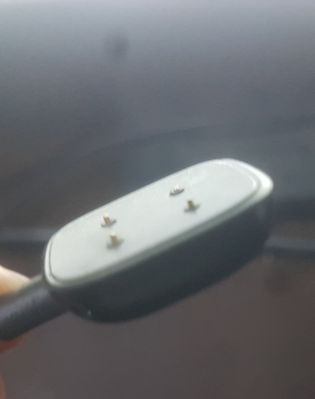

It looks like one of my prongs on the charger is pushed in a little bit.  Not sure how that even happened

On my fourth cable in less than a year.  One POGO pin spring breaks and the pin pushes in so that it doesn't contact the charging point on the watch. Given the number of failures just reported in this forum, I'd say it is an obvious, MAJOR design flaw.  I imagine I'll soon relegate this watch to the scrap pile and buy an Apple watch.

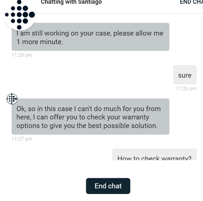

You must be lucky though. I just requested and the support centre declined my request straightforwardly. There is a definite issue with their charger and the upper left pin got stuck inside.

yes real lucky. Me, After less then a year didn't work.
They told me to buy an other one

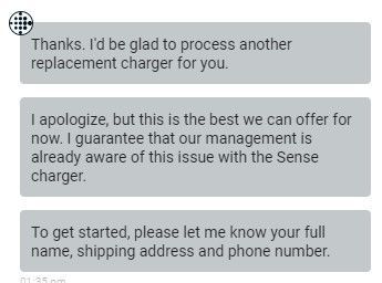

Now on my fifth replacement charger due to one of pins being pushed in. For the first time I got an acknowledgement from customer support that it is an ongoing problem and that management is aware of the issue.

I have 2 cables that have the pins or pin pushed in on the connector. I know why this happens and I can give them a solution of wanted. I was a molding engineer for 20 years and I know a lot about these issues and it is either a molding or potting issue (depending on how they do the connector.) the pins have to be made to not move once they are molded or potted. Not hard by very specific.
