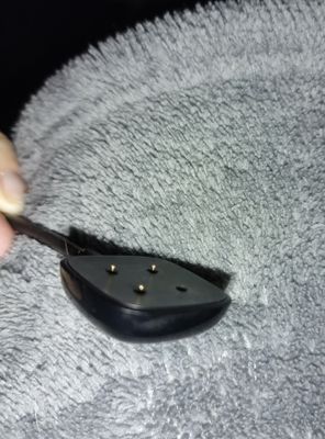

Ever since my Sense did the update it no longer will charge.  I have cleaned the sensors, uninstalled and reinstalled my sense and everything else I could.  My Fitbit is only 7 months old and really does not hold a charge for more than 24-36hours.
It looks like one of my prongs on the charger is pushed in a little bit.  Not sure how that even happened

I have exactly the same problem, it kept saying it was charging slowly or not charging at all and then I noticed the pin. I have emailed them and I'm awaiting a response. This is what mine is like.
You may be able to see my earlier post with a work around solution. Clean (4) sockets on watch gently with toothpick. Unplug cable from charging brick, attach it to watch, then plug it back into brick. Start with a new cable if you can to be certain all of the POGO pins are good. You may still get a slow charging message at times but the watch will charge fully without damaging the cable pins.

With a touch of my finger, all 4 of the pins freely move in and out.
That happened to my charger too. I just bought a new one on amazon and it works fine now.
Hey, I have had this problem 3 times now, really bad design of fitbit charger 😡 however I bought a compatable charger, this had same issue after time, but we cleaned the prongs with WD40 and tapped the charger on the table edge with the prongs facing the floor and this dropped the faulty prong back out... May not last forever (very doubtful🤭) but still charging my tracker so far... 🙏

I had an ongoing problem similar. Then some others on this support group said attach watch to charge first then plug it into the USB charger electric block. Once the pin no longer pops up, charger pretty much a goner.
It appears if you plug the charger in and then put the watch on it you end up frying some spring inside.
I've had a long run of success since plugging into electrical socket last.

Connect it to the back of the watch BEFORE plugging in the USB end and
remove the USB end BEFORE disconnecting from the watch.
The connector pins short out on the metal back of the watch and act like a
fuse.

Yes, This is the common problem. The charger/cable has the magnetic end with (4) POGO pins on one end and on the other end is a USB-3 plug that goes into the charging “brick” which plugs into the wall outlet. The fix is to unplug the brick from the wall outlet or the USB-3 plug from the brick. Then put the magnetic charger on the back of the watch (the charger cable should be new with all four pins fully extended) THEN plug the other end into the brick or the brick into the wall. To be doubly safe you can unplug the brick end first before removing the charger from the back of the watch.
You should also regularly clean the pin sockets on the back of the watch using a Q-tip with some alcohol. These tend to get clogged with oils and dust/lint that prevent a good contact for the charger.
