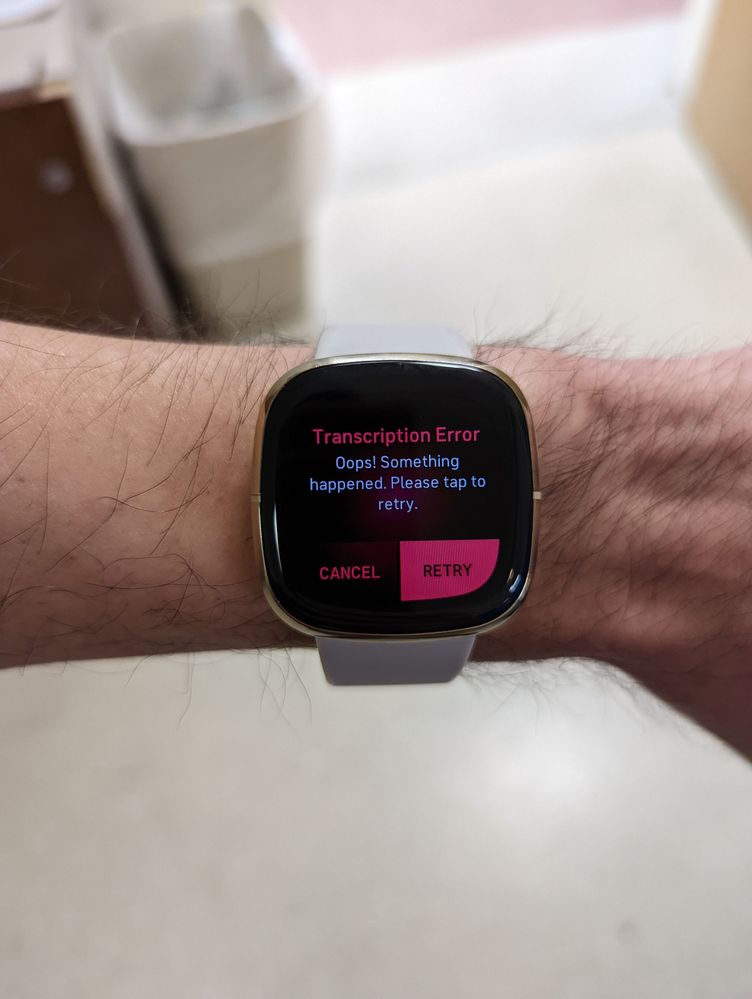

This morning my note 20 ultra updated to Android 12 and one ui 4.0. Ever since voice replies to text messages have stopped working.  When I attempt to use a voice reply my Sense either gives a transcription error, or says unavailable.  Strangely, google assistant is working so I know that it is not the microphone.  Any assistance would be greatly appreciated.
Edited to add troubleshooting steps:
I have:  forced stop, cleared cache, logged out and back into the fitbit app, restarted sense, restarted phone, checked that ALL permissions are allowed, removed Sense from the app and then set it up again, factory reset Sense and set it up again, uninstalled and reinstalled the fitbit app, checked the settings app in Sense to make sure microphone is on, checked to make sure all of the correct apps are set to "default", tested using both the stock Samsung messaging app and Google Messages app same results with both, checked battery settings to make sure the app is allowed to run unrestricted in the background, checked settings to make sure app is "kept open" and allowed to run in the background "at all times" .   Both the Fitbit app and Sense firmware are the latest version.
Nothing has worked. When I attempt to respond to a text message with a voice reply I immediately get either a "transcription error" or "unavailable" both of these errors occur before I can even begin speaking.  Interestingly, if I try to send a "quick reply" either an emoji or a text those work flawlessly.
This problem has only started after my phone updated to Android 12 and Samsung One UI 4.0.  Seeing as how others are having the same issue on non-Samsung phones I'm guessing this is an issue with Android 12.

same problem we are having on the Versa 3 and 2 watches   happened about 2 days ago... many different phones involved.  Samsung, Motorola , and now i read some google pixels..
well stated..  happening to SENSE, VERSA 2 and 3...

Okay I finally remembered to try to voice reply and something is definitely broken.
I tried to remove everything from phone, did a factory reset on watch
and started from scratch. Still did not work.

Thanks for bringing this to our attention. I'm glad to announce that this issue has been resolved! Please try using the voice replies on your Sense and let us know how it goes. You can always check this help article for instructions on how to use this feature.

I just tried one text reply and mine seems to be working now.

It is now working for me also. Thanks for taking care of the problem.
Thank you for the quick fix.  I can confirm it's now working again for me as well. 😊

Unfortunately, my voice replies still aren't working. I still have the same error. Is it possible that the update has not been released for the European part of the world?

Voice replies now work, but only if I'm connected to mobile internet with my mobile, but voice replies don't work when my mobile is connected to Wi-Fi. What can I try?
@hankaff It sounds like an issue with your home network or Internet service. Have you tried restarting your router to see if that fixes the issue?

@hankaff Thanks for keeping me posted about your Sense. Let me share that our team has bring a fix to all our affected members regardless of the location. I'm sorry you're still having this issue and as our friends mentioned, I'd also suggest restarting your watch, removing and reconnecting your Wi-Fi from the Sense's settings. Once that is done, try receiving a notification in order to test the quick replies and let me know how it goes.
Not resolved. I'm still getting the issue. Prior to this whole transcription error started, I could voice reply on any messaging platform, like Google chat,  what'sapp, facebook messaging, and my phones native messaging app. Now the only "resolved" issue is it only works with the default messaging app for my phone, android messages. Properly resolve this issue, not just half way please!

Thanks for joining this thread. I'm sorry the issue persists with your Sense and your husband's Versa 3. Because your post didn't mention, may I know if you've tried any other troubleshooting step prior to posting? Did you also try the the suggestions shared in this thread?
In the meantime, please give a try to the following:
  1. Forget your Fitbit device from the Bluetooth settings.
  2. On your phone's settings, tap Apps > Fitbit > Storage > Clear Cache.
  3. Go back one screen, tap Force Stop and reboot your phone.
  4. Open the Fitbit app, tap your profile picture > Set Up a Device.
  5. Select your Fitbit device, tap Replace Device and follow the on-screen instructions.
  6. Try using the voice replies one more time. For instructions, see this help article.
