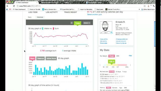

Best AnswerI finally got my Fitbit Data google spreadsheet to work with the help of this: https://github.com/loghound/Fitbit-for-Google-App-Script/commit/ea9242220489f2f3309d7560d404f281d482...
My original spreadsheet was created based on this: http://vimeo.com/26338767, but now updated with the above info to have the https modifications.
Just thought I'd share. . . .
