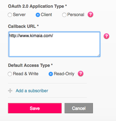

@JeremyDeveloper In your app settings of your registered app, your callback url should be this:
Your authorization url should then look like this:
