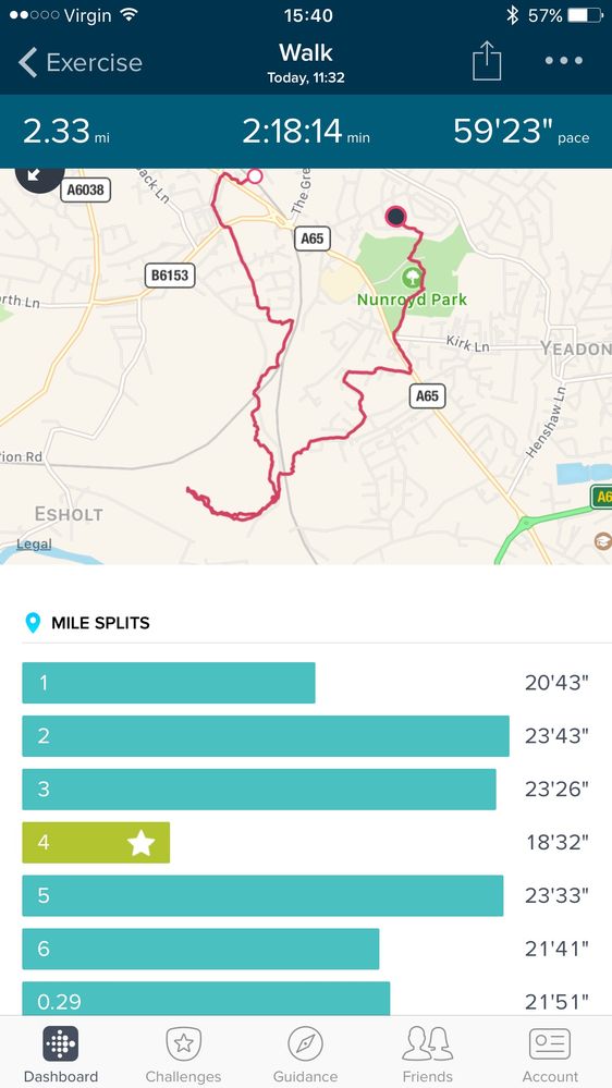

The issue started about 20/21 February. It is making the app completely useless for me.
I can can track my mileage, pace etc. right up until I finish the workout and then it messes up the figures.
As as you can see in the attached photo, the splits are recorded accurately, but the totalled figures at the top for mileage and pace are totally out.
I walked 6.29miles on the journey but only 2.33miles was logged and my pace was 1 mile per hour!
