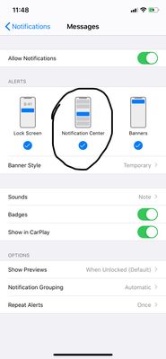

Best AnswerI think I finally found a fix - after 4+ months of no notifications, following the steps over and over, factory resets, app uninstall and reinstalls, clicking and unclicking buttons and no help from “Customer Service”, I’m finally receiving notifications.
In your settings, make sure “Notification Center” is checked. Then turn off your Fitbit and turn it back on and sync it. IDK why but that’s what finally worked.
I posted a screenshot and circled it. I have everything set to “Shows Previews When Unlocked” so no one can be in my business and it’s worked every time I’ve made my husband text me.

My Notification Center looks just like you have it pictured; it always has. I've never changed it. I don't get any notifications to my Fitbit.
I have just tried the Bluetooth reconnect again so will see if that works; although, I'm not holding my breath. I've tried all of the suggestions from this thread and from Customer Service multiple times and nothing has worked.
