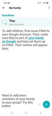

I bought a ace 3 for my daughter, im not a Fitbit user so had to set an account up 1st. I used my google account to log in. I set up my family how ever on my family it just say
to add children, make sure they're part of your family on Google, then set them up on Fitbit, their name will appear
I have made my daughter a account on my account as she is only 5 and added her to my family on google but nothing is showing up in my family on Fitbit app
please can someone help
thanks
