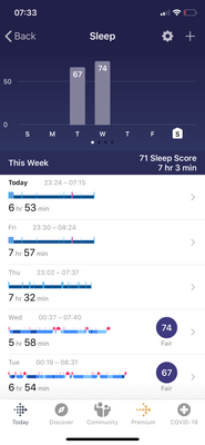

A few weeks ago a new area in the sleep log had an place for Sleep Scores. I found where to turn on this feature and have turned it on but for two weeks it shows the score category but never actually posts a score. Is there something I need to do for my scores to start posting?

I did try that Sally but to be fair I only selected the sensitive option on my iPhone. Surprise surprise no sleep score just loads of lines on the basic data graph.

Ditto. I was quite alarmed to see the amount of wide blue stripes and my supposed time asleep was scarily short.
