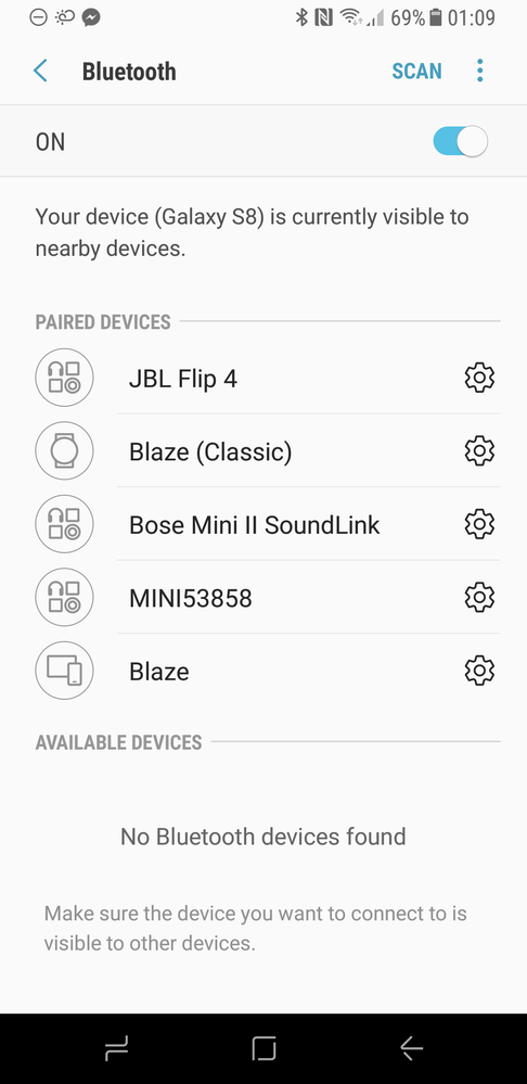

@TheAcornWarrior You do not pair the Blaze through the Bluetooth menu. It will fail saying pairing was rejected by the Blaze - this is by design. You must only add it via the Fitbit app. Only the Blaze (Classic) can be paired via the Bluetooth menu.
Once added via the app, however, Blaze will appear in the paired devices list in the Bluetooth menu. A screenshot of my Bluetooth screen is shown below:
Hope this clarifies things.
