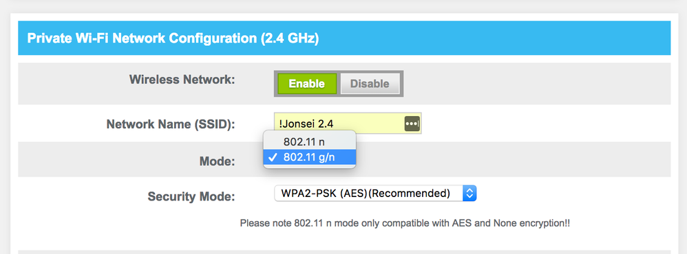

Except B,G,N is not an option to edit to. Only G,N

b/g/n is not an option anymore.  Any new options to solve this issue?

I have used this workaround many times, always successful.  However, Xfinity/Comcast has now disabled the option for the user to change the mode from b/g/n to g/n then back to b/g/n.  I confirmed this with Tier 2 support from Xfinity 12/15/18.  Now, you will have to call an Xfinity rep to do this for you.  I don't know if this is an Xfinity wide restriction or a regional one.  FYI I am in the Philadelphia market.
