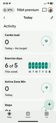

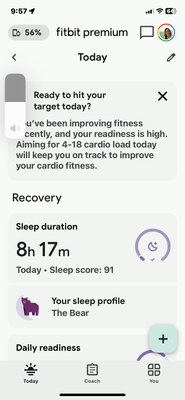

Hello @DavidFitbit - my Fitbit updated and still not seeing a cardio target in the tile or on the graph. When I click on it, I do get a message with target range that has an x in top right corner. The range disappears once I close it. It would be great to see what it is supposed to look like if it is working? Thanks for trying to d

Hello @Wonderthoughts
I've seen that some users needed to delete & re-install the Fitbit app in order for the Cardio Target Load to appear. I also have confirmation from an iOS user that doing this fixed their Cardio Load & Cardio Target Load issue.
Please let us know if you're still seeing the issue after trying the delete & re-install process.

Bingo! Finally got around to deleting the app and re-installing tonight. Yes indeed, the cardio target suddenly appeared in the tile and on the graph retroactively. 🤞
Thanks for letting us know that deleting & re-installing the Fitbit app worked to display your cardio target in the Fitbit app. 👍

Still not getting a cardio load target after uninstall and reinstall. Just the messages about a target range for the day.
