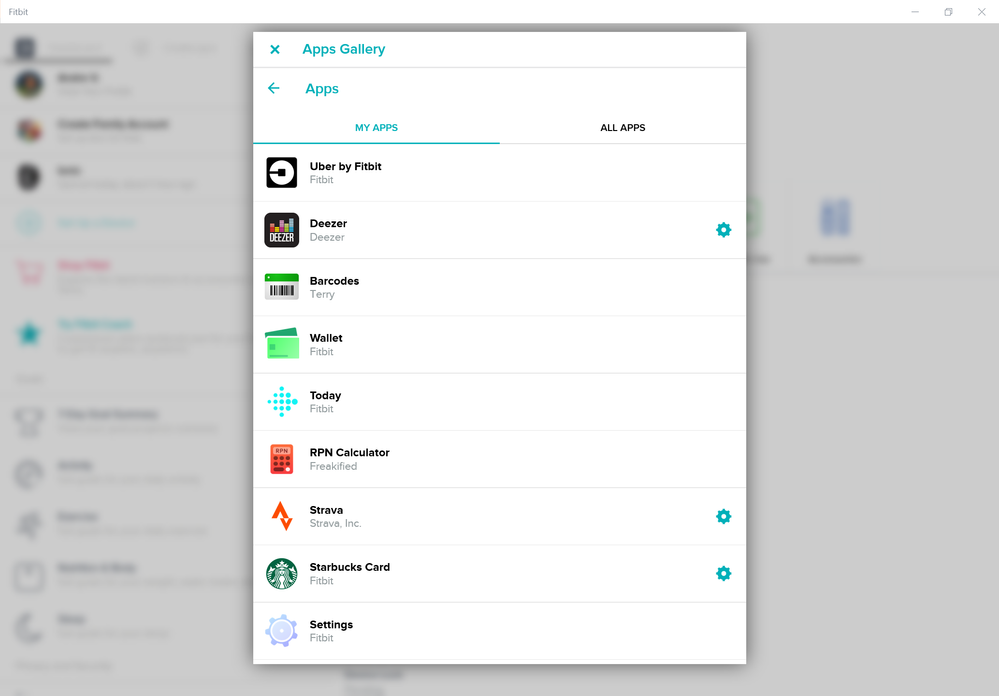

@SunsetRunner wrote:There is no way to add barcodes using my computer. My current phone is not that compatible with Fitbit and I had to remove the app from it. Do you have any workarounds? I can install the app using the computer (Windows 10), but not add codes.
I haven't tried it myself, but I once read on these forums a person who was in a similar situation and paired their watch to their computer over bluetooth and was able to access the settings page using the Fitbit app installed on their computer. Perhaps you could try the same thing.
Otherwise Fitbit third-party apps are developed according to Fitbit's app guidelines and adhere to a prescribed application architecture which means out-of-the-box configuration methods aren't supported, unless if a particular design warrants out-of-the-box methods for exceptional reasons like KiezelPay.

The Cog does not show up for the Barcodes app from Terry.
