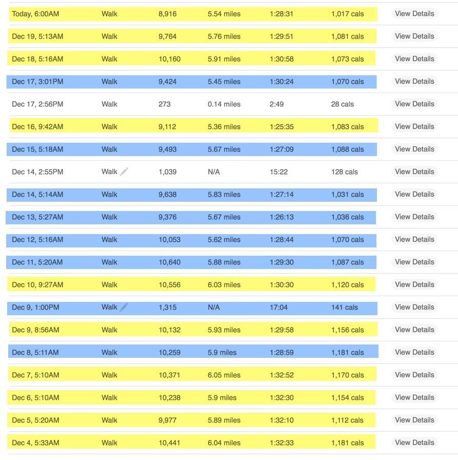

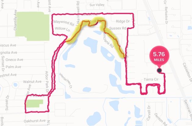

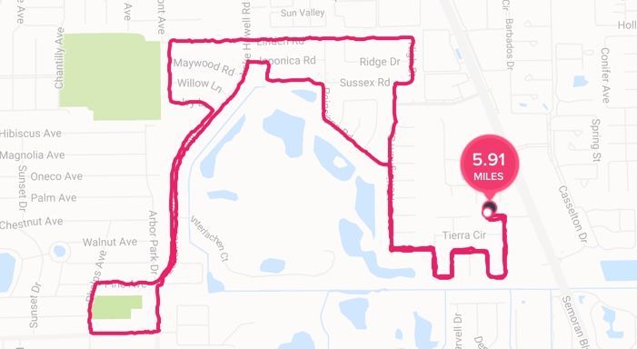

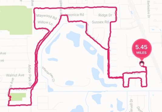

Figured I would offer up my experiences with extreme inconsistencies. I walk 5.5 to 6 miles every day. I walk essentially the same route with two possible variations at the end of the walk where I follow my starting route exactly for the last little bit and sometimes I cut it short with a bypass road if I am running short on time. The shorter route was always 5.5 miles and the longer was right around 6 miles using my Blaze linked to the gps on my iPhone. I got the Ionic to be able to leave my phone at home... The variations are incredibly frustrating as I like to duplicate and get similar results to compare. The following is the log of all of my walks back to December 4th. The yellow highlights are the longer walk, the blue highlights are the shorter walk:
There is a huge difference of almost 3/4 of a mile between the high and low gps distances on the yellow walks and just under 1/2 mile on the shorter blue walks. Step counts are all over the map as well. These are the two paths I take:
Yellow longer walk
Blue shorter walk
I also got this very strange result from my walk yesterday for the longer walk. Note the meandering path that in no way reflected the actual walk path that I take that the other maps tracked correctly:
Shorter walk with very weird invalid tracking highlighted in yellow
All of this is very frustrating. We have competitions within my office with prizes, etc that I am missing out on because of these inaccuracies, not to mention just the overall frustration with doubting the output from the $300 device. My wife's Apple watch is dead on with every walk both in step count and distance. Note the almost 1000 step count shortchange I got this morning... Between this and the issues with the bluetooth ear buds, I may have to learn to put up with the Apple watch's dismal battery life in exchange for valid readings and working bluetooth earbuds.
