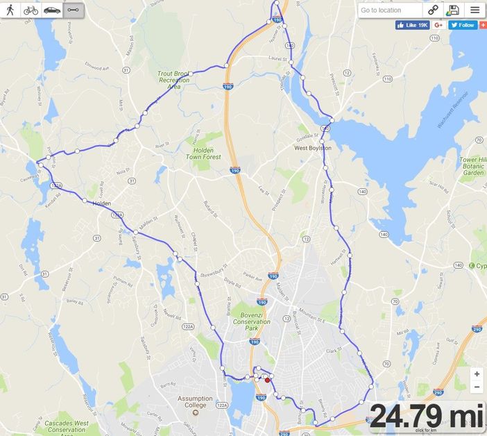

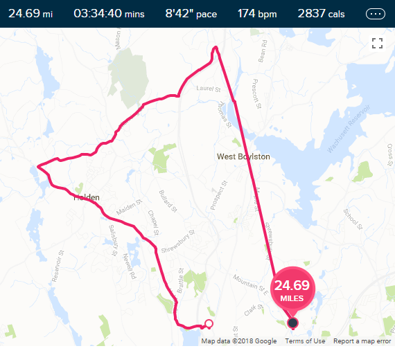

@SantiR, (assuming for a moment that you're not a bot) please consider a training run I did yesterday. It was warm, so I didn't need long sleeves and used the Run mod.
Somewhere after 12 miles I noticed I was no longer getting Pace displayed and, instead, the ionic displayed 'connecting'.
However, miles kept accumulating and overall pace was displayed. Here's the resulting map:Training run, fitbit.jpg.png
And here's the mapping I did on the net:
The distances are almost the same and overall pace was plausible for such a hilly course (altitude gain was 350 'floors'). But during the course of the run I had no idea if anything ionic was showing me was reasonably correct.
If I didn't have GPS, was this distance entirely determined by stepcount and stride length?
Is my ionic defective?
