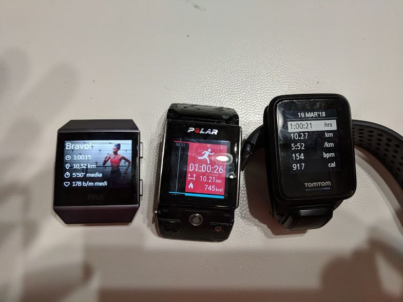

As promised I had a run this morning wearing the Ionic, a T0M T0M Runner 2 and a Polar m600.
I also set a 200 cm as stride for my run that is around double mine. However I confirm the distance tracked is still very good so my distance seems coming from the GPS.
Fitbit Ionic: 10.32 km
Runner 2: 10.21 km
M600: 10.27 km
I also uploaded the TCX files on https://www.sportdistancecalculator.com/ as suggested by @SunsetRunner and go the following:
Fitbit Ionic: 10.42 km (+0.1 km)
Runner 2: 10.27 km (+ 0.06 km)
M600: 10.31 km (+0.04 km)
All the devices show some differences and my interpretation is that it depends on the filtering of the GPS raw signal that for the Fitbit seems slightly more aggressive. However we are speaking about a difference of 1% from the minimum to the maximum distance that is definitely small
However I also did a test in my car and, with my surprise, indeed the distance tracked is 0. So I'm really puzzled. My best explanation is that the distance (at least for me, not sure why it should be valid only for me...) is that the Ionic checks if there is steps (measured by accelerometer) and only in this case it kicks in the recording and does not use the steps stride to measure the distance.
Still I'm confused about so many different results among the users (I'm very happy about mine) and we all are trying to interpret the resuls. It would be very easy if a Fitbit engineer clears the doubt and I can't understand why they keep us such in the dark.
