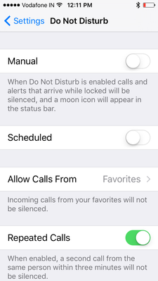

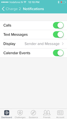

Since last week my charge 2 is not showing me any notification (calls, text, 250 steps reminder, etc.). I have all notifications turned on.
I restarted the device once but still no luck.
Please find screenshots for my charge 2 notifications and my iPhone settings.
Any help would be highly appreciated.
