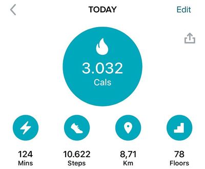

I have reached out to support. First via Twitter, now in a mail exchange. Going through the motions of trying all the work-arounds and ticking all the support boxes. Restarting (15 sec’s reset while on charger), Bluetooth re-pairing, firmware check, stairs counting, ladidadida...
Here’s today’s result so far:

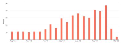

Same here. Got the replacement and saw an immediate change back to "normal". Question is whether it was in fact a faulty batch, or still a design flaw that will lead back to the same weird readings in a couple of months.
For reference:
As you can see, the Charge 2 performed quite stable and consistent throughout 2018. Early 2019 I switched from Charge 2 to Charge 3 and then the readings went up and showed silly numbers up until the replacement early 2020.
