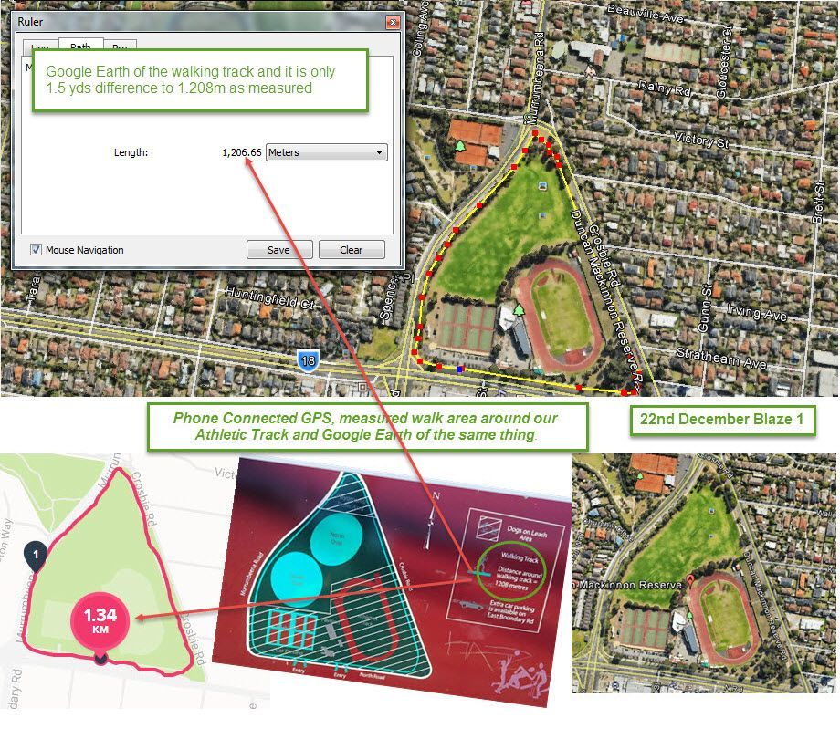

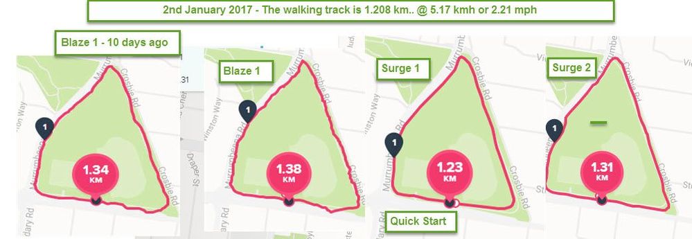

I have a closed case with Fitbit Blazes on the under reporting of distance by about 20% for domestic use. No solution. On a planned walk at exercise speed the distance isn't too bad.
Support had me changing stride length, setting to auto stride and using Connected GPS. Hence the images below. No solution, it is with the Engineers......
I have multiple Trackers and in the tests it was my Blaze 1 and the 2 x Surges.  For domestic walks, all of my trackers, which includes the earlier Charges are accurate for distance because it definitely multiplies steps x stride as defined. (ignoring missing steps). But the Blaze seems to invoke the 3D accelerometer and I was wondering how your domestic use of the Charge 2 goes.  Domestic, meaning home, shopping, malls, car parks etc.. No GPS....Because a step is a step...
The GPS varied on the Surges but the Blaze was about 12% over. I hadn't used the 2nd Blaze in this test.  The 2nd image shows a Google Earth plot of the same track and I had also confirmed it with MapMyRun.

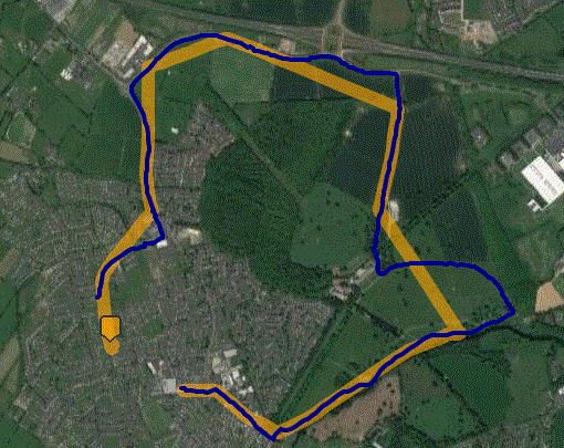

Can anyone tell me if the Fitbit team are looking into the Connected GPS issue as I purchesed my Charge 2 in January and am very dissattisfied with it. I use a Samsung 7 phone and as I told the Fitbit help it provided a very satisfactory trail map but the Charge 2 contains too many straigh lines and sharp corners. The attached photo shows the Charge 2 route in orange with another products blue track superimposed. I have no issue with the blue track as it leaves no doubt as to the route I took.MyGPSFiles.gif
