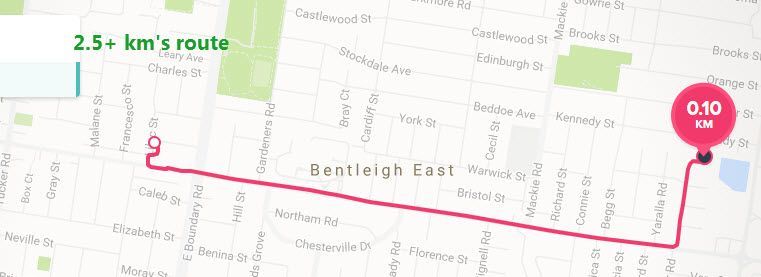

I have tested my routes with MapMyRun and Polar and also activated the Connected GPS for a  typical motor vehicle trip to the supermarket in a mainly East/West route for for 1.5+ miles (2.5+ km's) and this was the result. You couldn't get a straighter path. There is virtually no distance because the Fitbit didn't detect my movement.  Aim to test the Connected GPS before my walking tests.

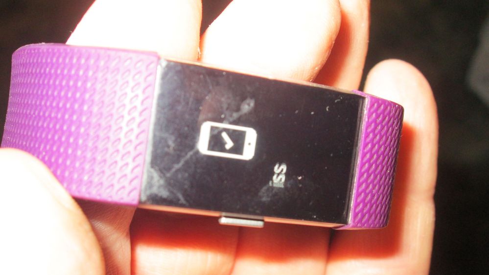

Here what I have found. I took a walk on Wednesday. I started the fitbit app up first. Then start the charge. At the top was the phone icon and it showed it was searching. I started walking. Then it buzzed me and it showed the phone icon with a check mark in the phone icon. Then it said push button to continue. I already had the other program. When I finished it was .01 off. That is the closet I have had it. I had as much as .10 off.
This is what you get when your phone is connected thru the fitbit app.This is what you get when your phone is connected thru the fitbit app.
