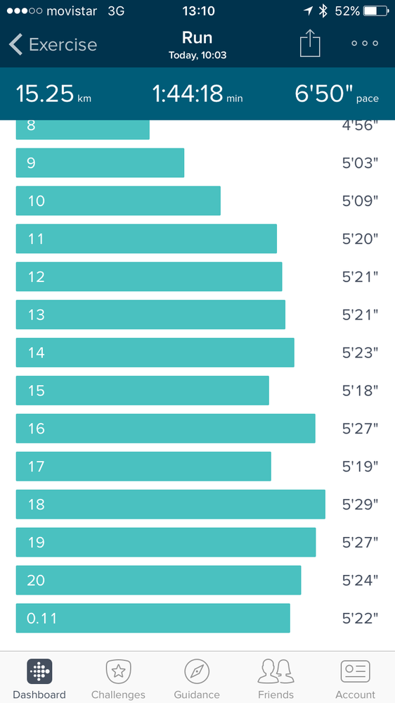

Hi @majbugman. Yes, it seems you can't start a bike excercise with the app. And on top of that, now there is an issue with the tracking of the app since feb 22. Multiple users are reporting that in other forums. Just check my today's run, tracked using the app:
It was 20k, and all the splits are showing that, but the excercise summary on top shows 15.25k. And the pace is 6'50", although when I finished the run the fitbit was showing 5'11".

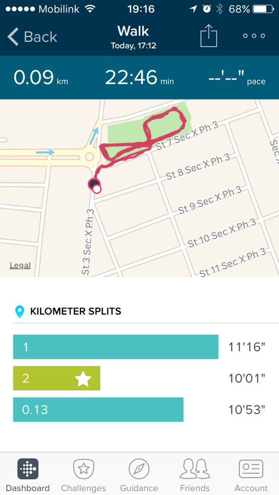

I am having exactly the same problem for the last ten days. The walk is tracked accurately on GPS and also as time & distance splits, BUT the summary gives much reduced distance & speed. Please help. IMG_2160.PNG 0 Vote
Walk summary is wrong, whereas the split times & distances are correct

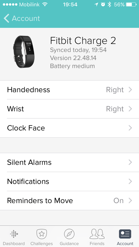

I have the latest SW/firmware for my Charge 2, but the problem is NOT solved, the snapshot below shows the split distances correctly, BUT the summary is very WRONG.
