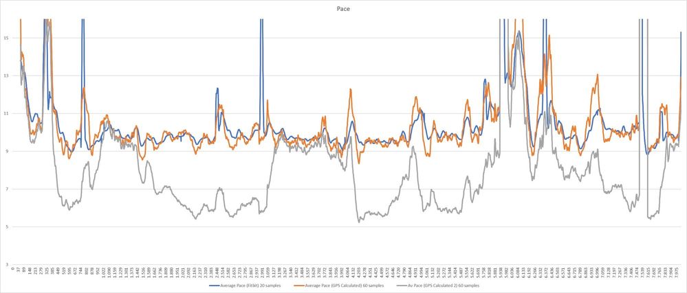

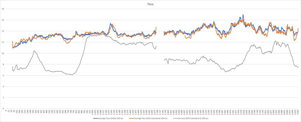

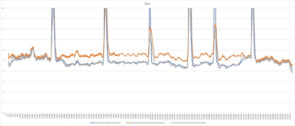

Following @Rollerskier post, these graphs are the results of analyzing TCX files from Australia, Norway and Chile. First, there are three lines in each graph:
- Blue: Pace according to the Charge 2.
- Orange: Pace calculated using the time and GPS coordinates from the TCX file
- Gray: Pace calculated using an incorrect method, which is basically ignores that the distance between longitud coordinates varies depending on the latitude .
So, in theory,  the Charge 2 blue line should always be very close to the Orange line. But these are the results:
ChileChileAustraliaAustraliaNorwayNorway
Conculsions:
- In Norway, the blue line and the orange one are close. The Connected GPS works fine.
- In Chile and Australia, the Charge 2 line (blue) is not close to the orange line. Instead, it is close to the gray line (i.e. the incorrect method), thus giving incorrect pace and distance readings.
I was able to replicate very accurately the incorrect Pace shown by the Charge 2, and I did it using only the GPS information of the TCX file, without using the stride length information. Therefore, this is not a problem of poor GPS signal (or bluetooth), and it isn't using the stride length to calculate pace.
The problem is that the Charge 2 is using incorrectly the GPS coordinates: The algorithm to translate coordinates into distance contains an error. Moreover, while in some locations the algorithm works well, in others it doesn't.
Anyone wanting to submit a TCX file is wellcomed, just drop me a message and I'll give my personal email. Thanks @Rollerskier and @Glennbest for submitting theirs.
@DerrickS, I hope this info helps the team to correct the error in future firmwares.

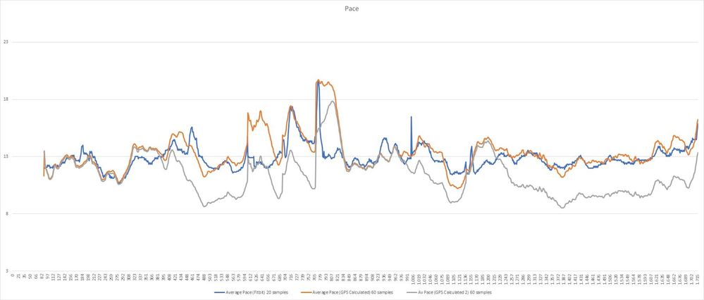

Thanks to @Kenny54, we have now a 8k TCX file from Ireland. In this file, the blue line of the Charge 2 is close to the orange line, which means that the Charge 2 is correctly translating coordinates into distance.
So far we've analyzed 4 locations. The two from the southern hemisphere (Australia and Chile) show the error while the two in the northern hemisphere (Norway and Ireland) seem to be  right.

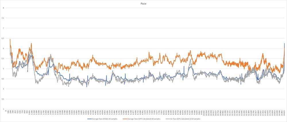

Here is a new graph, now from @hawkeye1952 in Nebraska. Again, northern hemisphere has a correct use of coordinates:
He is nevertheless showing inaccuracies at some points, but not sure of the reason. But in the end, the total distance and average pace are within a 1% error (orange vs blue line).

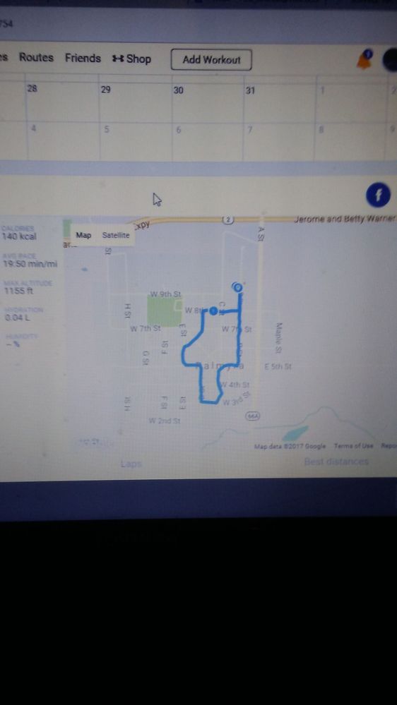

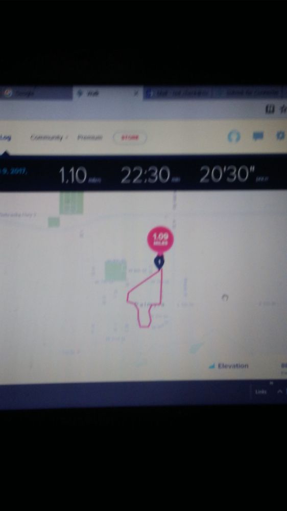

I took my morning walk. I use my main program and fitbit. My main program showed 1.17 miles and fitbit charge2 1.10 miles. way off. I also notice that it did not map it correctly either
This is fitbit mapThis is fitbit map
Tjis is the endomondoTjis is the endomondo
