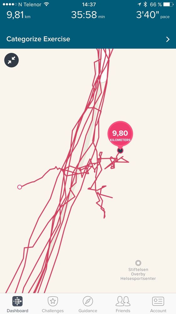

Start up, breaks and shut downs of a run.
I mentioned previously that Fitbit records distance when you are not moving as well.
I have attached a run were you can study this(zoomed in on a section of the track).  Anybody else has this problem?
You can see the horisontal lines in a wobbling pattern.  These represents distance that is not real.  Point 9.80 km represents the time were I stopped the recording.  Open circles represents the time when started the run.  Both these placed are geographical wrong.  I started and stopped in the middle of the vertical lines.  The vertical lines represents different laps on a round trip track. The overall distance roller skiing is not that wrong when the speed is around 20-30 km/hour.  However, if I stop for a break (without pausing the recording) in an interval training the distance continue to record in this wobbling pattern.
