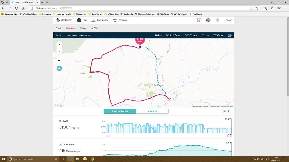

My Charge 2 still seems to be logging more steps and miles than my other device and the App on my mobile. The Connected GPS function still does not map my track correctly.
If anyone has a suggestion on how to improve the function of the device / app please let me know.
FAILED TRACKFAILED TRACK

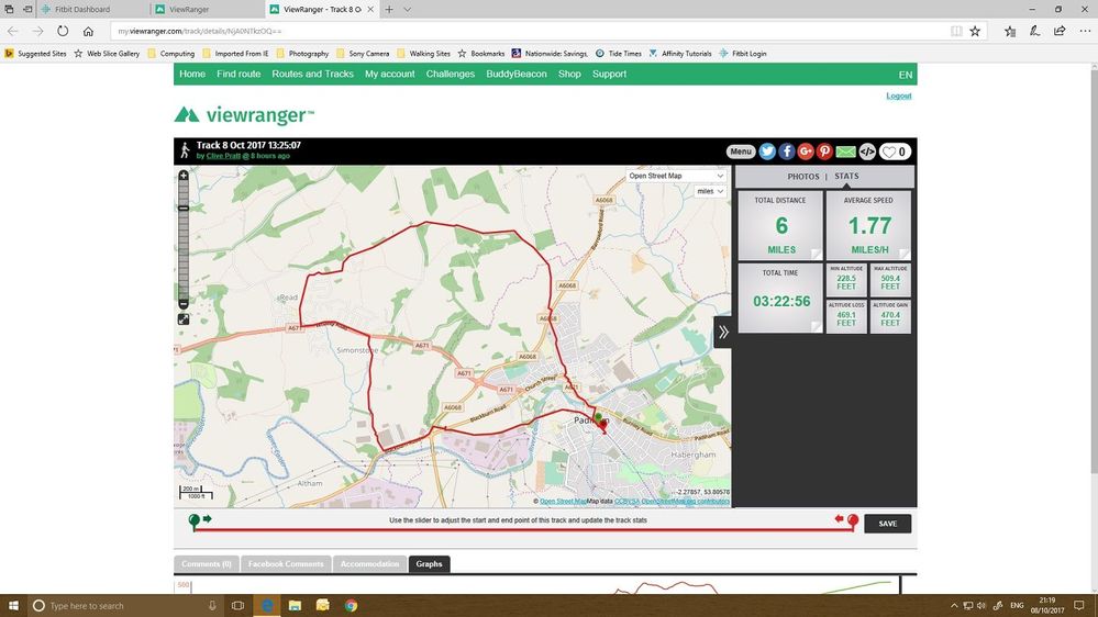

I use the Fitbit app version 2.59 on my mobile and I also use the Viewranger app to track my route, as it is more accurate.
I also carry a Omron Walking Style IV 3 axis pedometer to cross check my steps and distance.
The attached pic shows the track recorded by the viewranger app which proves to me that my mobile phones GPS is working correctly.

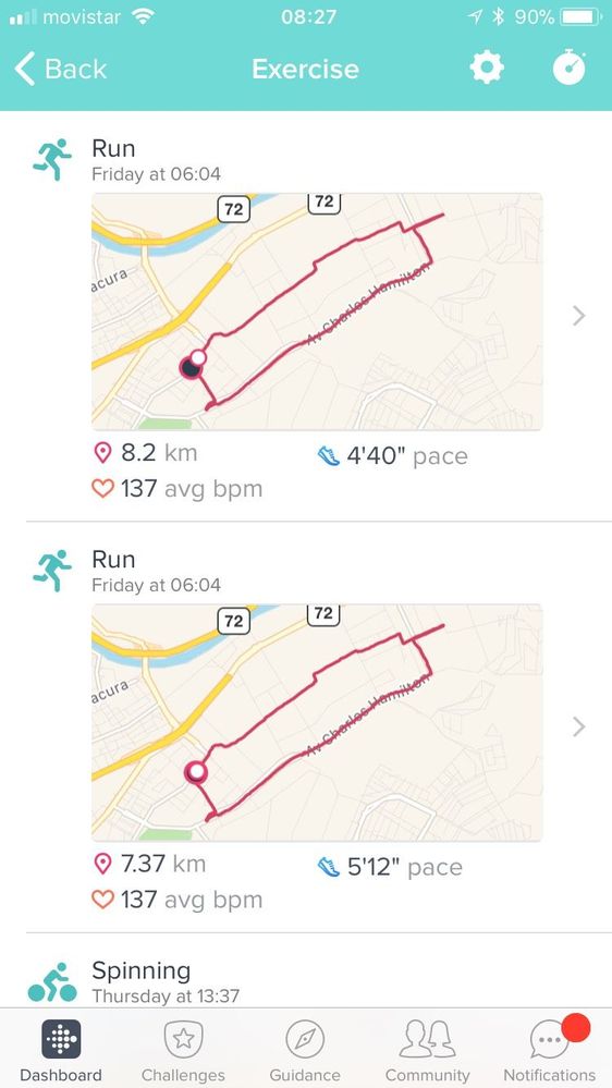

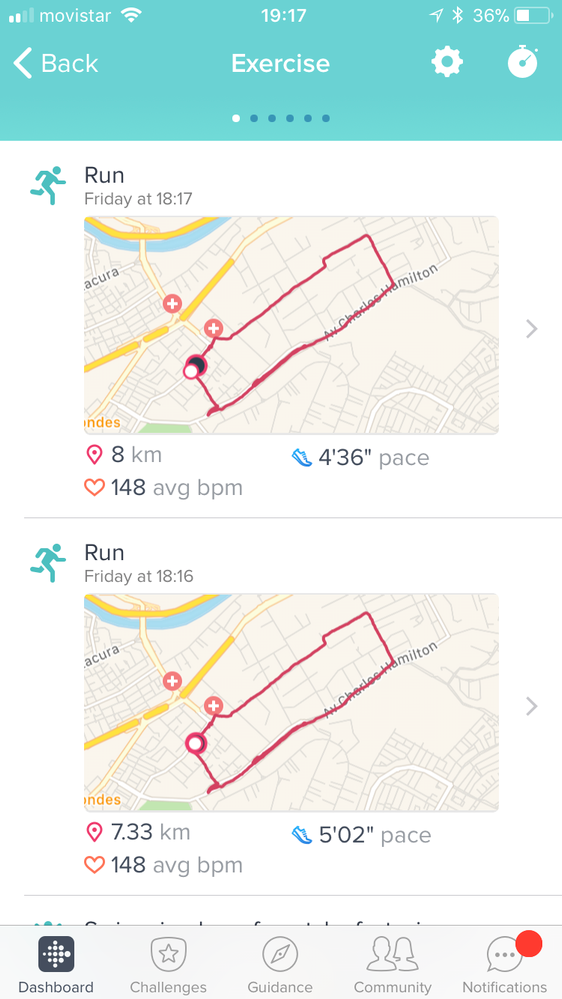

Today I ran again using both IPhone tracking and Connected GPS. Still incorrect measurement from Connected GPS. Analyzing the TCX file, it still asumes that there are 111,200 Km per long degree (which is right if you are in the equator), instead of ~93,000 Km for my latitude. Can't believe they can't solve something this simple!
Today I switched to IPhone 7. I did the same test again, and guess what? Same results, Connected GPS keeps measuring distance incorrectly
Upper image is Connected GPS, lower is direct track with IPhoneUpper image is Connected GPS, lower is direct track with IPhone
