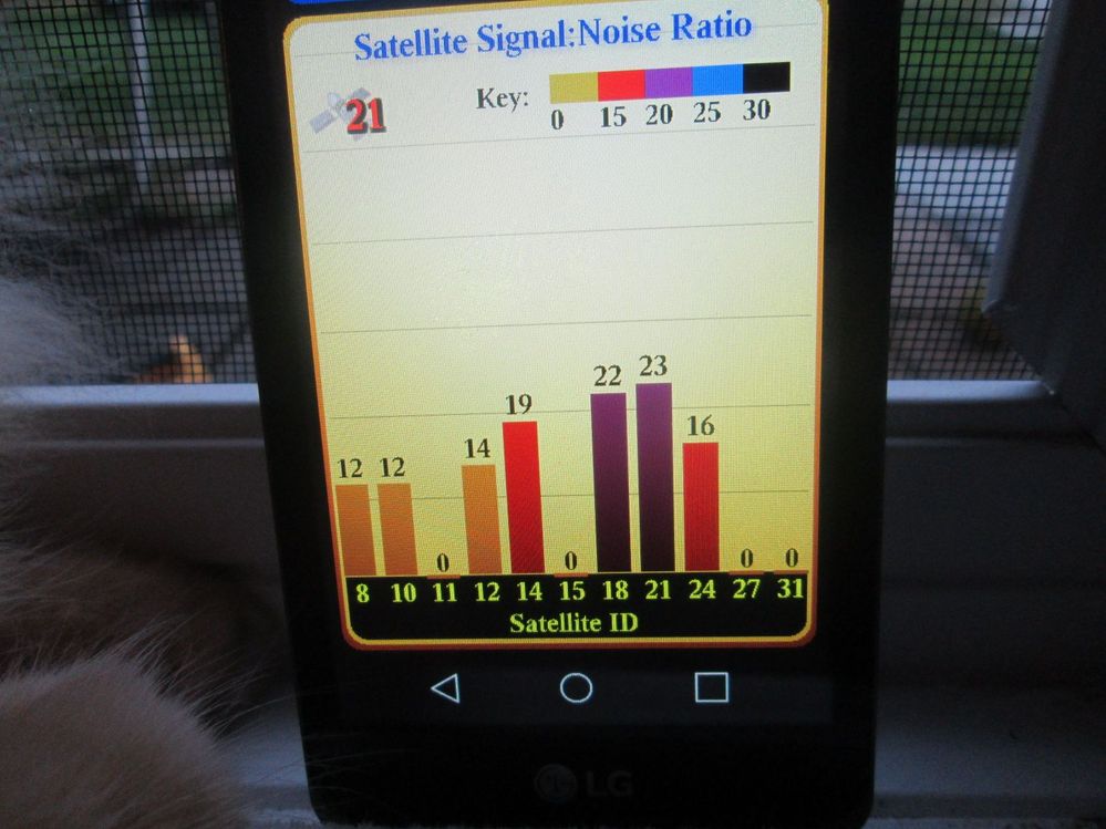

Here is something I just learned. It takes 3 satellites to give you accurate position. There is another side to this. It call noise ratio which has to do with the signal strength. In my house right now I have 3 to 4 satellites which my program accesses. They have a very low noise level or very poor to poor signal strength. When I put it up to the window I get 5 or more satellites that read from poor to very good depending on the satellite number. I think the main problem with fitbit is that it can not lock on to more than 1 or 2 satellites here a picture of my satellitesthis the strengtht of my gps singnals at my windowthis the strengtht of my gps singnals at my window
I did some testing of accuracy of GPS for Apple technical support before.  If you like to check your phone GPS accuracy position yourself on a spot you can easy recognize on the map.  Like a street corner or road crossing. Open a map that plots your position and compare this position with were you are physical standing. If the phone signals are weak the position will move around.
I took my morning walk today. Using both the fitbit app and my regular program. Both where started at the same point. Then I check my satellites strength. When I start I had 7 that were very good and several other listed as good. I also check them along the route. Total distance was 1.7 miles. fitbit app 1.48 miles. Again it failed to give the right distance traveled.
@hawkeye1952 Thanks for keeping us up to date. What App are you using because I'm testing my Ionic and it can take up to 2 minutes to connect. My satellite App only shows the strength which is always good.

My main fitness program is endomondo. There are 2 features that are wonderful. 1st one tell you when you lose your gps signal and when it is restored. 2nd one is when hit the start button it tells you to go. Which means it as locked on to the gps signal. Takes anywhere from 1 second to 5 seconds..
The one that gives me the gps satellite signal strength is called gps waypoints. It also has a mapping feature. The time I have compared the 2 they been right on.
@hawkeye1952. The App your suggested was a great help today.. I had 7-8 satellites and the Ionic connected immediately as did MapMyRun and the tracking was within acceptable limits and no wobbly paths on each.  But I used Run instead of Walk for my Walk.. as recommended by some moderators in similar posts about GPS...
