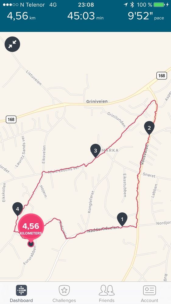

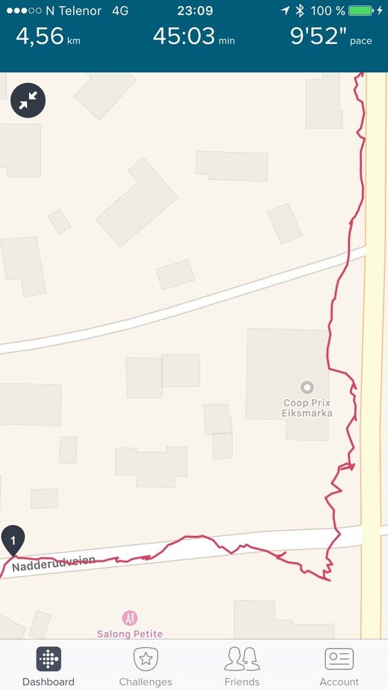

Hei, this issue is not solved. I have just received a replacement Fitbit Charge 2 and I still have the same issue with GPS Distance tracking in both excercise RUN and WALK mode. Please see my recent comments on this tread with examples. I am using iphone 6+ and 7 with ios 10.1.1 and the latest Fitbit app and the firmwire 22.44.12 on the tracker. The GPS data is zick zacking and obviously calculating the length following this path with no consistant direction gets much longer. Data need to be smoothend. If you have 5-10 m inaccuracy with every samling GPS point everything gets far off if you just draw a strait line between every point.
